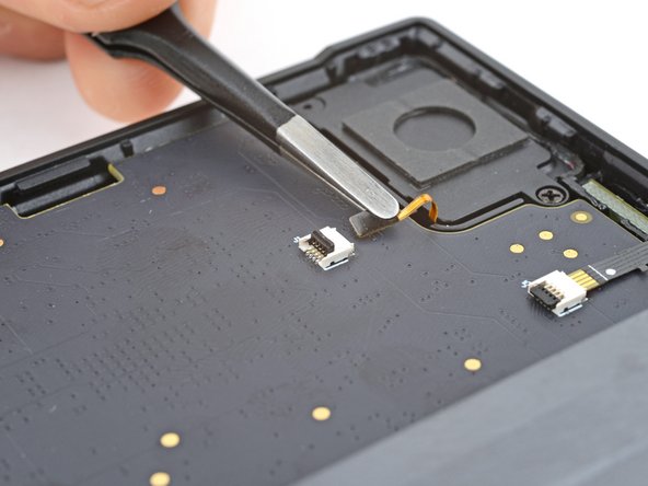

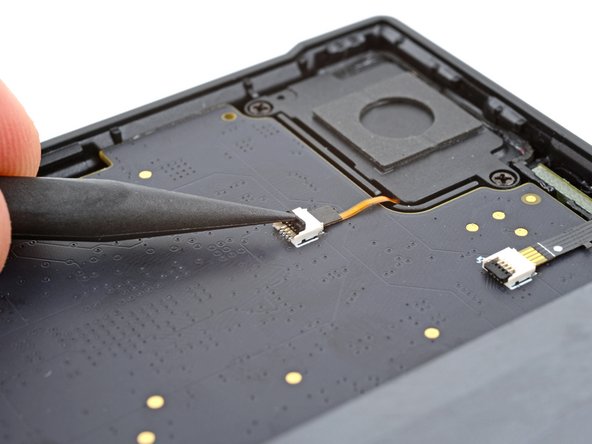

Disconnect the speaker
  • The left speaker will be on your right-hand side, as the device is laying upside down.
  • Use the tip of a spudger or a clean fingernail to flip up the hinged locking flap on the left speaker cable ZIF connector.
  • Use blunt nose tweezers to pull the cable straight out of its socket.
