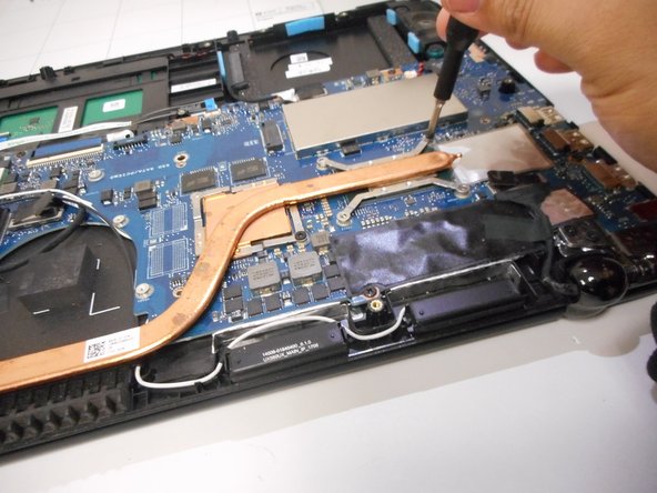

  • Remove five 3 mm screws holding the heat sink in place using a Phillips #0 screwdriver.
