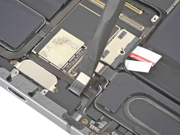

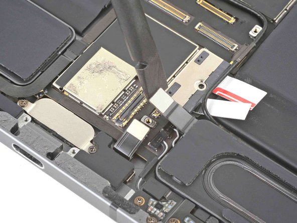

Disconnect the Smart Connector and SIM card reader
  • Use the flat end of a spudger to disconnect the Smart Connector and SIM card reader cables.
  • For the Wi-Fi only model there is no SIM card reader cable.
