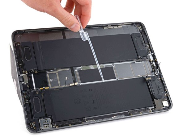

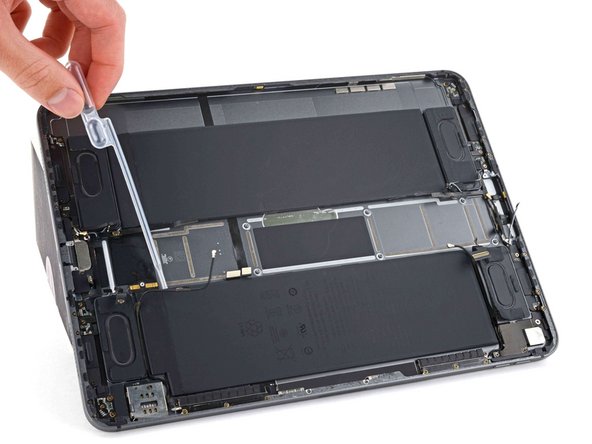

Apply isopropyl alcohol
  • If you removed all of the stretch-release adhesive, good job! You can skip the next four steps. If not, then follow the next four steps to apply isopropyl alcohol.
  • Prop the left side of the iPad up against an object so the isopropyl alcohol can flow under the right battery cell.
  • Apply high-strength (>90%) isopropyl alcohol along the inside edge of the right battery cell.
  • Be careful if you're using a syringe with a needle or other sharp instrument to dispense isopropyl alcohol—a punctured or bent battery may leak dangerous chemicals or cause a fire.
  • Let the alcohol soak for two minutes to soften the adhesive under the battery cell.
