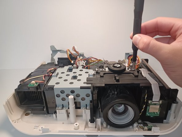

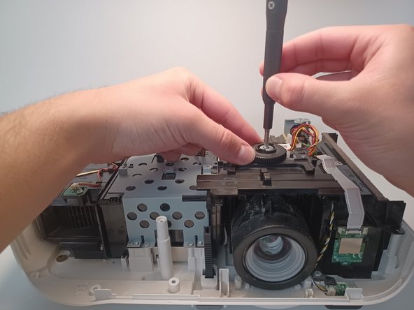

  • Remove the 7.5 mm Phillips #1 screw.
  • Remove two 6 mm Phillips #1 screws.
  • Set the black plastic lens sliders to the side.
