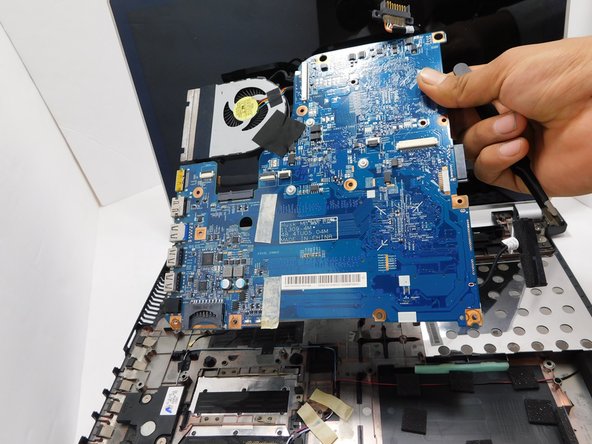

  • Place fingertips on edges of motherboard to prevent damage to the circuitry.

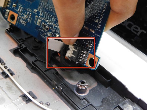

  • Remember to disconnect this RAM cable on the bottom of the laptop. This can also be accessed and disconnected from the RAM ports on the backside.
  • Using your fingertips, grip the edges of the motherboard to prevent damage to the circuitry.
  • The motherboard should lift out easily.
