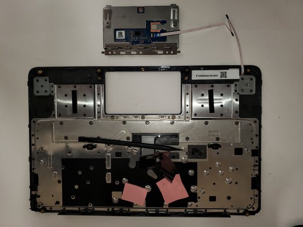

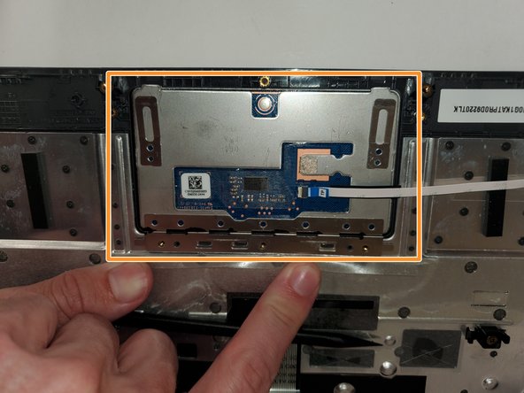

  • Using a spudger, remove the touchpad bracket.
  • Push up on the touchpad from the keyboard side and remove the touchpad.
