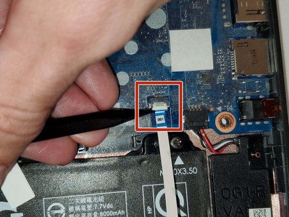

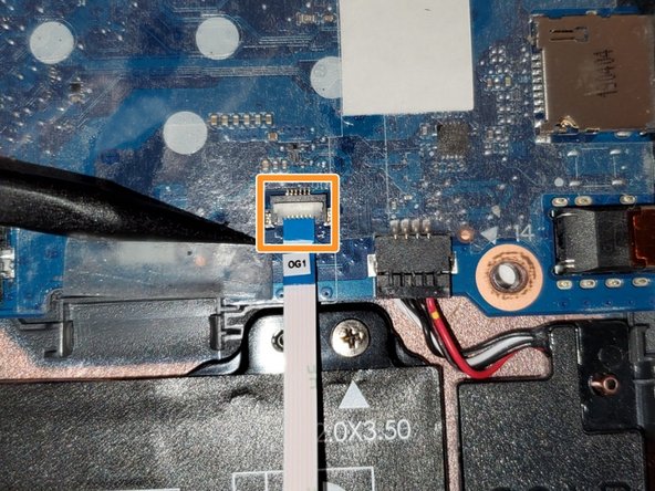

  • Peel back the tape that secures the battery cable connector to the system board.
  • Using the pointy end of the spudger, lift the tab lock up that holds the ribbon cable in place.
  • Slide the battery cable out from the connector.
