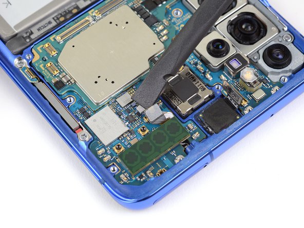

Remove the upper 5G mmWave antenna
  • Use the flat end of a spudger to pry up and disconnect the 5G mmWave antenna module.
  • Use the flat end of a spudger to pry up the corner of the antenna module.
  • The module is secured with a bit of adhesive, but should release easily.
  • Remove the mmWave antenna module.
  • During reassembly, reconnect the antenna connector first to properly align it into place, then firmly press the rest of the module down to adhere it.
