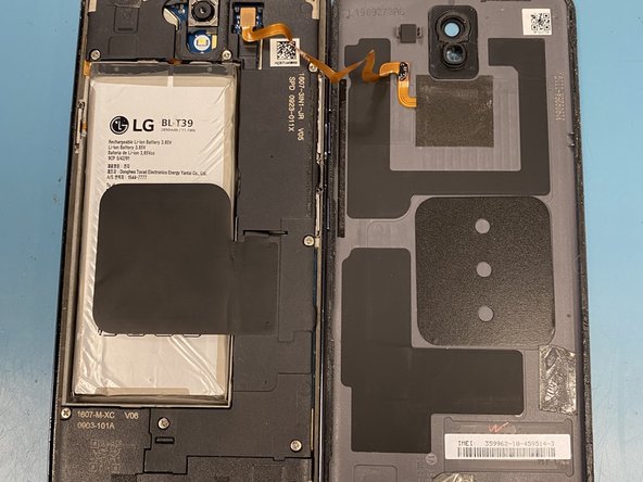

Stap 2
LG K40 Disassembly, Removing the Back: stap 0, afbeelding 1 van 2 LG K40 Disassembly, Removing the Back: stap 0, afbeelding 2 van 2
Removing the Back
  • Once the phone is hot to the touch, place the phone screen facedown away from the heatpad.
  • Use your spudger, and carefully pry the back off of the Phone. Be extra careful to not damage the rear camera ribbon cable.
  • Once the back is free, place it next to the phone for continuing the disassembly.
