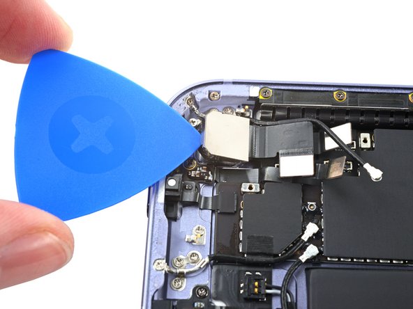

Pry up with the opening pick to fully separate the rear camera from the frame.
If you're having trouble separating the adhesive, reapply the iOpener for 1–2 minutes and try again.
