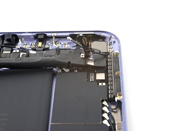

Disconnect the rear camera
  • Use a spudger to pry up and disconnect the rear camera's press connector.
