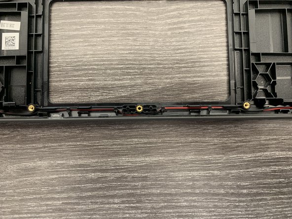

  • Next up are the two stereo speakers located in the bottom corners of the device. These can be removed by simply lifting one speaker straight up, navigating the wire out from the tabs, and lifting the other speaker out of its housing.
  • The speakers cannot be removed unless you first remove the trackpad.
