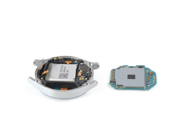

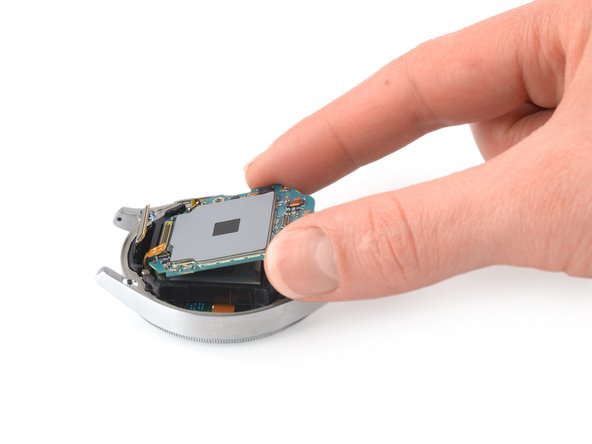

Remove the motherboard
  • Use your fingers to lift the motherboard out from the watch assembly towards the bottom of the watch.
  • During reassembly, make sure none of the flex cables become trapped underneath the motherbaord.
