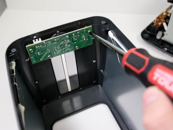

Stap 7
Toaster Made by Design model KT-3215 Teardown: stap 0, afbeelding 1 van 2 Toaster Made by Design model KT-3215 Teardown: stap 0, afbeelding 2 van 2
  • Place the toaster casing upside down.
  • Use a Phillips #2 x 4in. screwdriver to remove the four 0.25 in. Phillips head screws. These screws are securing the control board for the buttons and timer knob.
