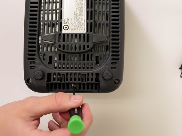

  • Use a TA 2.3 screwdriver to unscrew the five triangular screws on the bottom of the toaster.
