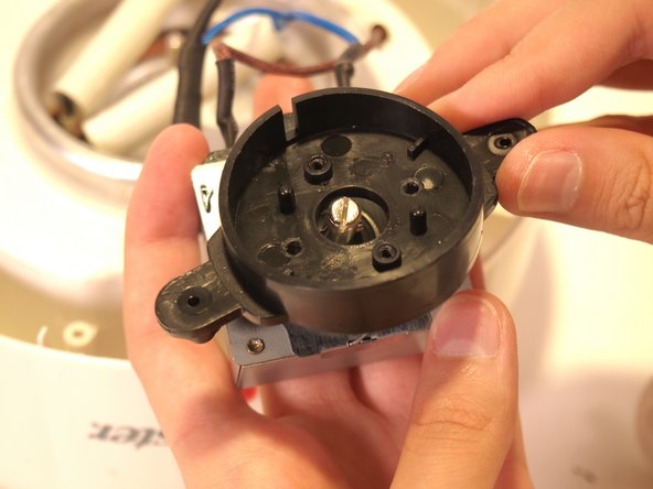

  • Using the JIS #1 screwdriver, remove the two 4.3 mm screws from the right and left side of the timer.
  • Using your hands, lift off the black plastic cover.
