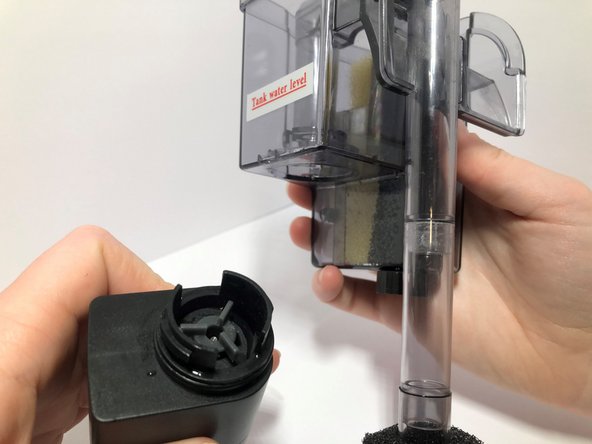

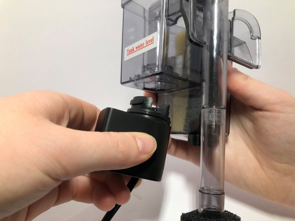

Pull down to separate the motor from the filter.
Steady force is needed to separate the pieces.
Potential for device damage: Pull straight down to avoid damaging the rubber water seal.
