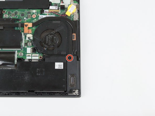

  • Use a Phillips #1 screwdriver to remove the single 5 mm screw from the speaker to the right of the internal battery.
