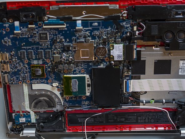

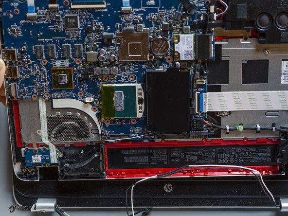

Move the top cover aside
  • Now the top cover is completely disconnected from the display panel and it is free to move. Grab it at the short edges and take it out of the display hinges by sliding it forward and tilting it up a little.
  • Leave it then aside for a while.
