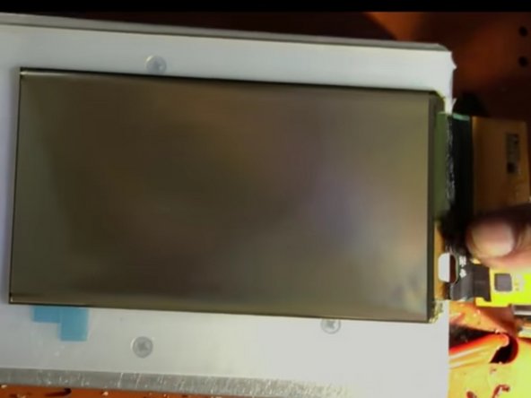

  • Using a freezer, we separate the AMOLED display from the glass.
  • We take the screen polarizer film off, and we find out that the screen is really a silver-ish color, not black!
  • However, you technically won't be able to see any text or images on the screen without the black polarizer film.
