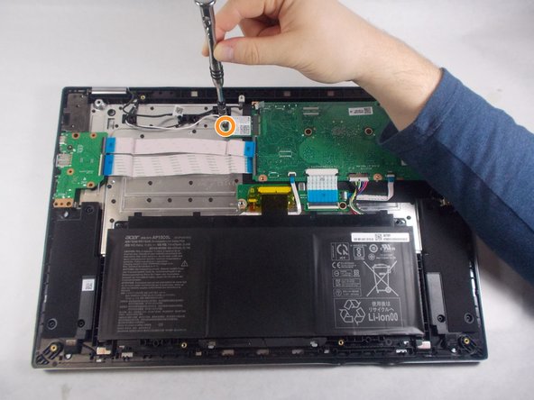

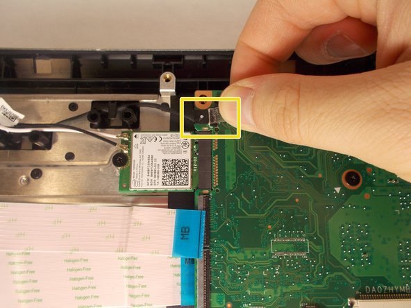

  • Unplug the camera/microphone ribbon cable from the circuit board.
  • Remove the single 3mm Phillips #1 screw from the Intel core.
  • Unplug the cable from the circuit board.
