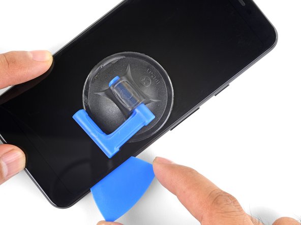

Slide the pick along the right edge, slicing through the adhesive. Do not insert the pick more than 1/4" (6 mm), or you may damage the screen's flex cable. Leave a pick in place to prevent the adhesive from resealing.
  • Slide the pick along the right edge, slicing through the adhesive.
  • Do not insert the pick more than 1/4" (6 mm), or you may damage the screen's flex cable.
  • Leave a pick in place to prevent the adhesive from resealing.
