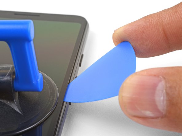

This step shows how to insert the pick without damaging the OLED panel. Do this before you slice either long edges of the phone. With the pick 1 mm in the gap, pivot the pick upwards to a steep angle. At this angle, carefully push the pick into the gap about 1/4" (6 mm). The pick should slide in below the OLED panel.
  • This step shows how to insert the pick without damaging the OLED panel. Do this before you slice either long edges of the phone.
  • With the pick 1 mm in the gap, pivot the pick upwards to a steep angle.

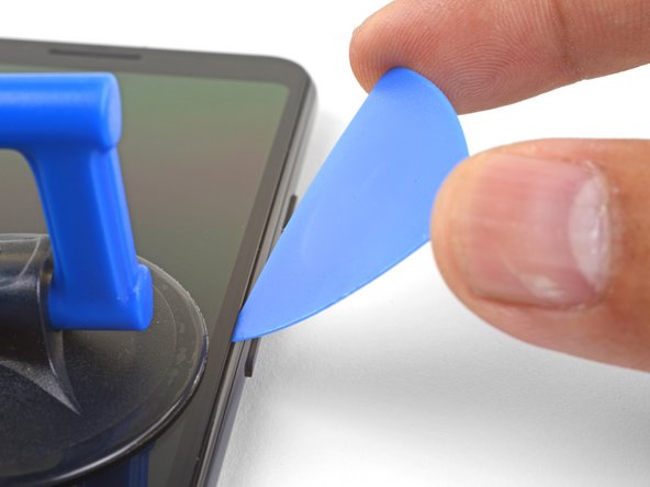

  • At this angle, carefully push the pick into the gap about 1/4" (6 mm). The pick should slide in below the OLED panel.
  • Stop if you feel the point of the pick hitting a ridge. The pick may be pressing against the edge of the OLED panel. Angle the pick and try again.
