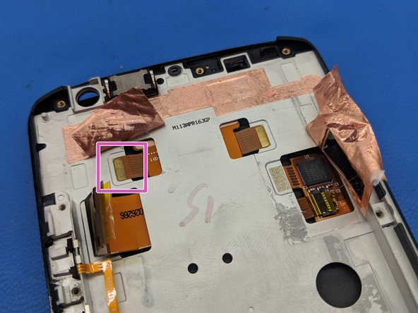

Carefully peel up the bottom part of this piece of copper tape and fold it over. Using the point of a spudger, detach this display cable tab from the frame.
  • Carefully peel up the bottom part of this piece of copper tape and fold it over.
  • Using the point of a spudger, detach this display cable tab from the frame.
