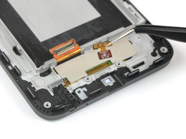

Use a pair of tweezers to gently peel off the RGB LED notification indicator. Remove the RGB LED notification indicator.
  • Use a pair of tweezers to gently peel off the RGB LED notification indicator.
  • Remove the RGB LED notification indicator.
