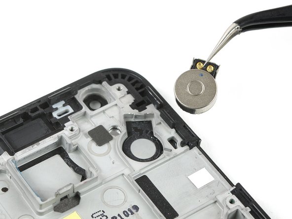

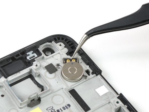

The adhesive underneath the vibration motor is strong. Use an iOpener on the top part of the screen for about 30 seconds to loosen it. Use a pair of tweezers to pry up and remove the vibration motor. Use a pair of tweezers to pry up and remove the vibration motor.
  • The adhesive underneath the vibration motor is strong. Use an iOpener on the top part of the screen for about 30 seconds to loosen it.
  • Use a pair of tweezers to pry up and remove the vibration motor.
