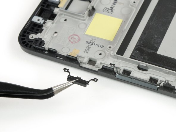

The power and volume buttons are held in position with small rubber feet sitting on small plastic elevations. Use a pair of tweezers to free the rubber feet and lift the power button upwards.
  • The power and volume buttons are held in position with small rubber feet sitting on small plastic elevations.
  • Use a pair of tweezers to free the rubber feet and lift the power button upwards.
  • Remove the power button.
