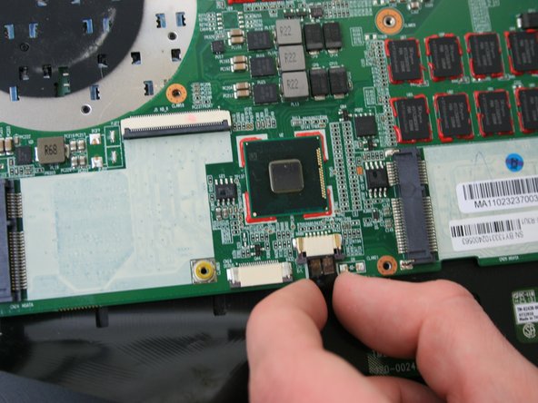

Stap 5
Razer Blade RZ09-0102 Motherboard Replacement: stap 0, afbeelding 1 van 2 Razer Blade RZ09-0102 Motherboard Replacement: stap 0, afbeelding 2 van 2
  • Remove the wire located close to left hand side black ribbon cable. Pull down on both sides of the connector to remove.
