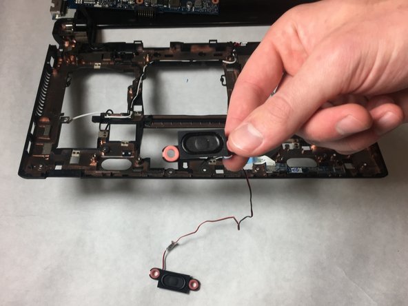

  • Remove the black tape over the wire, holding it in.
  • Remove the wire from under the hooks keeping it in place.
  • The speakers and wires are now ready to be removed, and new ones installed.
