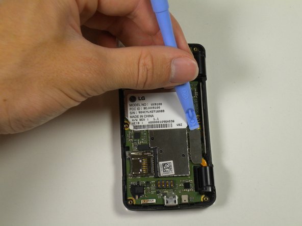

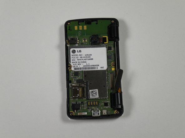

  • Locate the silver strip connected to the logic board. The silver strip is closest to the bottom hinge of the phone.
  • Wedge the plastic opening tool in between the silver strip and the logic board.
  • Lift the plastic opening tool to separate the silver strip from the logic board.
