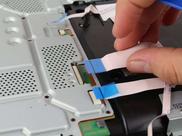

  • Remove the connections by pulling out on the blue tabs with your fingers.
  • Flip up the black clip on the largest tab with your finger before removing it.
  • Remove this wire connection by firmly gripping the wire with your fingers and pulling it out.
