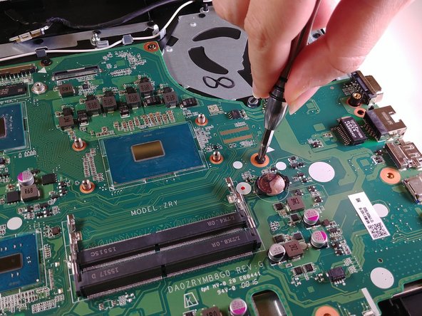

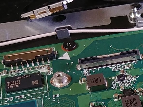

Use a Phillips #1 screwdriver to remove the 3 black 10mm Phillips Head screws securing the motherboard to the face-plate of the device.
Note that each of the holes for these screws are marked with a small white triangle.
