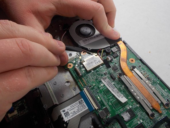

Place the back of the spudger under the black wire that connects the wireless card to the motherboard. Flick the spudger up to disconnect the cable from the motherboard.
  • Place the back of the spudger under the black wire that connects the wireless card to the motherboard.
  • Flick the spudger up to disconnect the cable from the motherboard.
