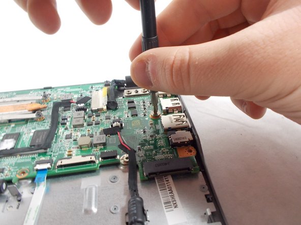

Acer Chromebook C720-2827 Motherboard Replacement: stap 0, afbeelding 1 van 2 Acer Chromebook C720-2827 Motherboard Replacement: stap 0, afbeelding 2 van 2
  • Using the Phillips #1 screwdriver, remove the four 3.0mm screws.
  • Loosen the six 3.0mm CPU screws using the Phillips #1 screwdriver.
  • The six 3.0mm CPU screws do not come out of the motherboard.
