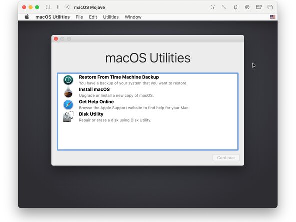

    8. Virtualizing macOS on Intel, Boot into recovery: stap 8, afbeelding 1 van 3 Virtualizing macOS on Intel, Boot into recovery: stap 8, afbeelding 2 van 3 Virtualizing macOS on Intel, Boot into recovery: stap 8, afbeelding 3 van 3
      • Press the play button on the left to start the VM.
      • Verbose mode is enabled on this ISO, so lots of text will fly across the screen. What the text says doesn't matter; just let it run in the background.
      • You'll also see a button briefly pop up that says Install macOS version. You don't need to do anything when you see this screen, as it picks the correct option for you.
      • When the installation is complete, you'll also see Macintosh HD as one of the options.
      • After a little time, you'll see the VM boot into macOS recovery. This is the expected behavior.

    9. Virtualizing macOS on Intel, Formatting drive: stap 9, afbeelding 1 van 1
      • Right now, the internal drive is completely blank and unformatted, therefore you cannot directly install macOS on it.
      • Open Disk Utility and select QEMU HARDDISK Media.
      • Erase the drive. Name it Macintosh HD and set the format to APFS for Mojave and later and HFS+ for High Sierra and before.
      • After this has finished, you can close Disk Utility.
