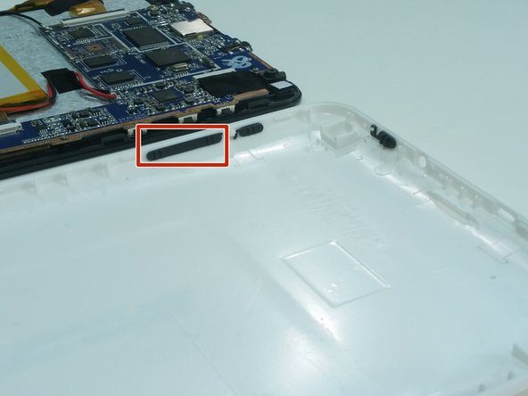

    • Use a 1 cm wide plastic opening tool to remove the back panel. Go around the entire back panel to ensure safe removal.
    • The power, return, and volume buttons are not firmly secured to the panel; it is likely they will fall off in the process of removing the panel.
  3. Tagital T9X Volume, power, or return button Replacement, Volume, power, or return button: stap 3, afbeelding 1 van 1
    • Remove the broken volume button from the plastic case. Replace it with the new volume button, with the + being closer to the camera opening.
    • There are two other small buttons that look very similar to one another; if they fall off as well, put them back in their rightful place.
