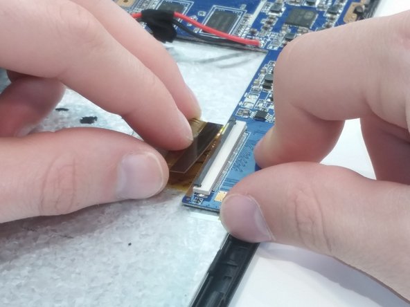

  5. Tagital T9X Screen Replacement: stap 5, afbeelding 1 van 3 Tagital T9X Screen Replacement: stap 5, afbeelding 2 van 3 Tagital T9X Screen Replacement: stap 5, afbeelding 3 van 3
    • Locate the 2 ZIF connectors.
    • Remove both ZIF connectors by lifting the flap on the connectors and carefully removing the ribbons.
