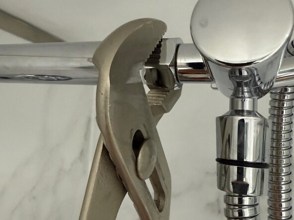

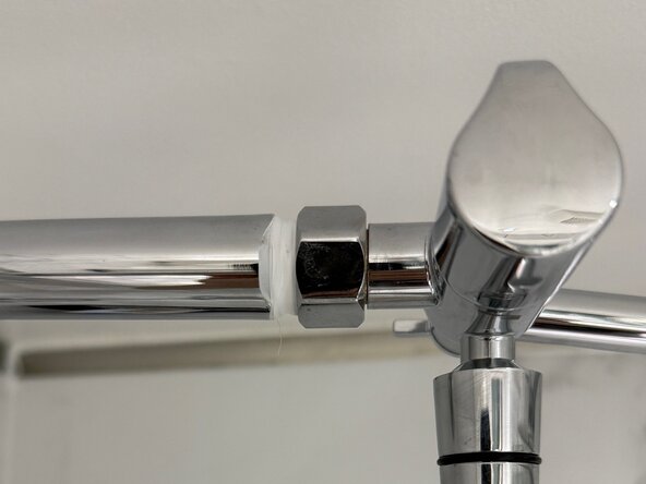

  2. Shower Arm Replacement: stap 2, afbeelding 1 van 3 Shower Arm Replacement: stap 2, afbeelding 2 van 3 Shower Arm Replacement: stap 2, afbeelding 3 van 3
    • Use an adjustable wrench to loosen the nut that connects the shower head to the shower arm.
    • Turn the nut counterclockwise until the shower head comes off.

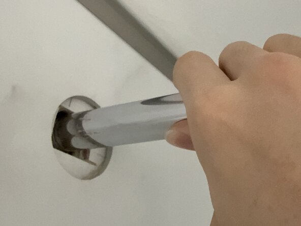

  3. Shower Arm Replacement: stap 3, afbeelding 1 van 1
    • Gently slide the decorative flange (the round metal cover) away from the wall.
    • This exposes the threaded connection where the shower arm enters the wall.

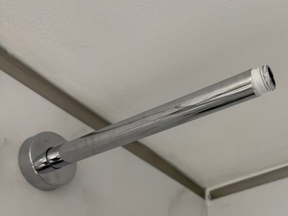

  4. Shower Arm Replacement: stap 4, afbeelding 1 van 1
    • Grip the shower arm with a wrench covered with a cloth or rag to protect the finish and turn it counterclockwise. Continue turning until the shower arm fully unscrews from the wall fitting.
    • Use a cloth or rag between the wrench and the shower arm to prevent scratching the finish.
