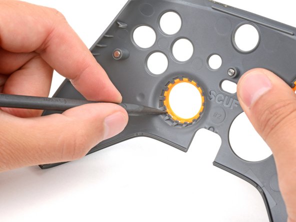

  3. Scuf Instinct Pro Thumbstick Rings Replacement, Remove the thumbstick rings: stap 3, afbeelding 1 van 3 Scuf Instinct Pro Thumbstick Rings Replacement, Remove the thumbstick rings: stap 3, afbeelding 2 van 3 Scuf Instinct Pro Thumbstick Rings Replacement, Remove the thumbstick rings: stap 3, afbeelding 3 van 3
    • Use the point of a spudger to push out and unclip the joystick ring from the faceplate.

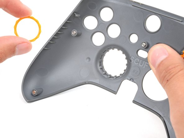

  4. Scuf Instinct Pro Thumbstick Rings Replacement: stap 4, afbeelding 1 van 1
    • Use the same process to remove the other joystick ring.
