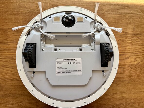

    • Remove the dust collector bin
    • Turn the robot upside down and remove the spinning brush

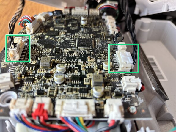

    • Flip the body around (wheels on bottom)
    • The upper and lower body are still connected by 3 cables.
    • Carefully pull the upper body to open, so you get a view to the inside
    • Disconnect 2 connectors (green marked)
    • The 3. cable (blue marked, to LIDAR) doesn't need to be disconnected. Take a moment to learn the cable trace inside the body for the reassembling
