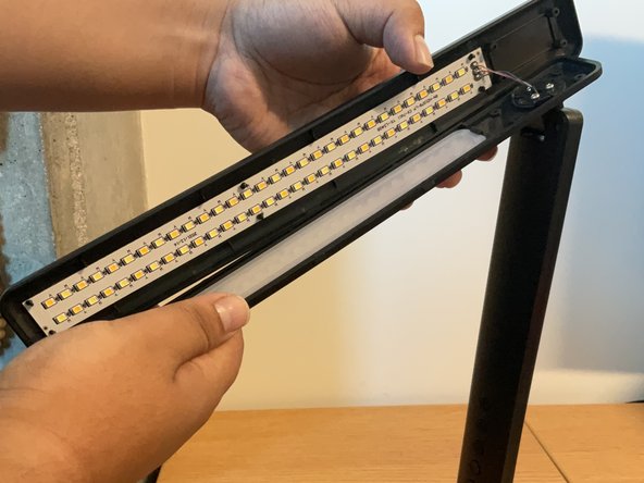

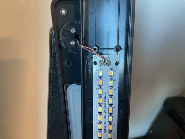

  4. Poukaran ZRW-TD-SRK2 LED Replacement: stap 4, afbeelding 1 van 3 Poukaran ZRW-TD-SRK2 LED Replacement: stap 4, afbeelding 2 van 3 Poukaran ZRW-TD-SRK2 LED Replacement: stap 4, afbeelding 3 van 3
    • Use a soldering iron to carefully desolder the wires connecting the faulty LED strips. Ensure you're desoldering the correct connections. Solder the new LED strips in place, connecting the wires securely to the designated points on the lamp's circuit board.
    • Exercise caution when lifting the plate that holds the LEDs, as there is a risk of accidentally pulling out the wires.
