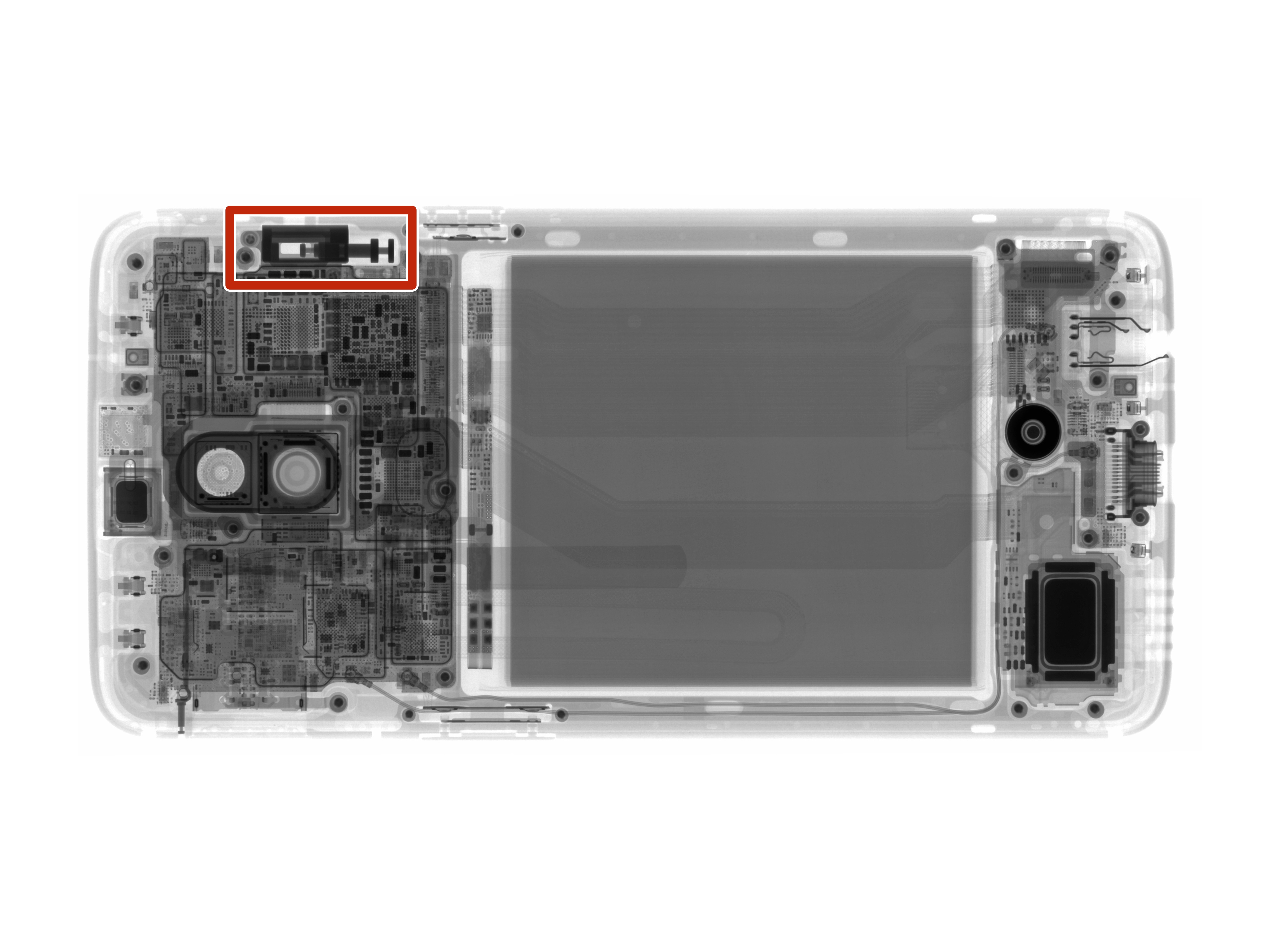

    • No need to go in blind when you have X-ray vision—our friends at Creative Electron give us an overview of this smartphone's terrain.
    • Everything looks pretty standard—except for the huge sliding mechanism for the alert slider! If we didn't know any better we'd have guessed it was some kind of linear actuator.

    • Nine Phillips screws bite the dust and the plastic antenna frame doesn't budge. But a secret tenth screw behind a liquid damage indicator grants access.
    • Under the plastic midframe, we get up-close and personal with that oversized slider mechanism.
    • The slider button moves a hefty metal plunger, which flips a mechanical switch soldered to the motherboard. The X-ray image provides an even better view.
    • Why the seemingly overwrought design? Is it something to do with ingress protection? Or maybe it gives the switch better tactile feedback? Share your best guesses in the comments.

I can’t fully grasp what that huge plunger is doing, even with your description and images. I’m 100% confused
Dave Davidson - Antwoord
I’d guess it’s there for better alignment. The detent on the 3T that I have works well, but there is some play introduced because the slider can roll slightly on the head of the switch, giving it some slop.
sawyer bergeron -
Is the vibrator a linear system or a rotating one? I remember seeing a casing similar to this one on the S6 and S7 (which gave strong, quiet vibration) but it could just be a circular rotating assembly like on the original Nexus 5 (which was honestly horrible.) I’m hoping it’s the former, as that would be a significant upgrade over the standard barrel motor vibrator on previous Oneplus phones.
sawyer bergeron - Antwoord
The vibrating motor looks like a rotating one from the pictures above (Step 11 picture).
