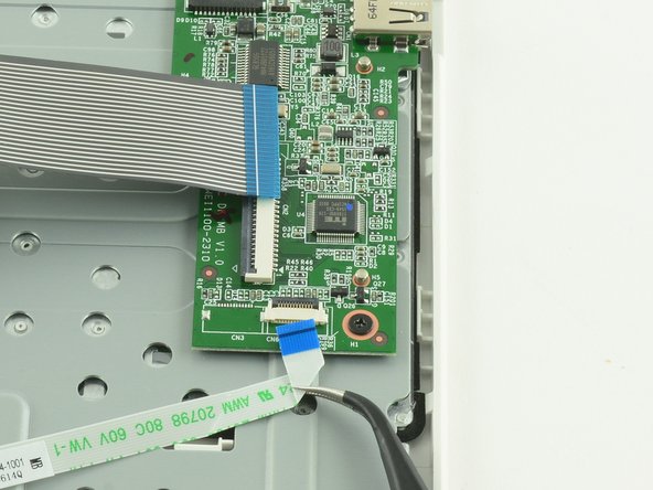

  5. One Education Infinity:One Daughterboard Replacement, Daughterboard: stap 5, afbeelding 1 van 2 One Education Infinity:One Daughterboard Replacement, Daughterboard: stap 5, afbeelding 2 van 2
    • Flip up the black retaining flap on the ZIF connector holding the large grey ribbon cable in place.
    • Pull the ribbon cable straight out of the ZIF connector.
  6. One Education Infinity:One Daughterboard Replacement: stap 6, afbeelding 1 van 2 One Education Infinity:One Daughterboard Replacement: stap 6, afbeelding 2 van 2
    Gereedschap gebruikt in deze stap:
    • Use the flat end of a spudger to flip up the black tab on the smaller ZIF connector.
    • Use tweezers to pull the ribbon cable straight out of the connector.
  7. One Education Infinity:One Daughterboard Replacement: stap 7, afbeelding 1 van 3 One Education Infinity:One Daughterboard Replacement: stap 7, afbeelding 2 van 3 One Education Infinity:One Daughterboard Replacement: stap 7, afbeelding 3 van 3
    • Use a Phillips #000 screwdriver to unscrew the three 3.4mm screws.
    • Lift the daughterboard away from the device to remove.
