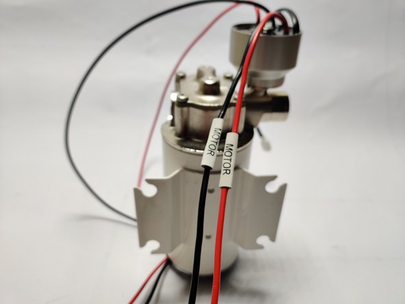

  7. Marco UP Series Electric Pump Electronic Sensor Replacement, Check how long you want to strip off the cable: stap 7, afbeelding 1 van 1
    • Use the joint as a reference on how much you need to remove.
    • Keep in mind that you want to have as much wire inside as possible, but you want to avoid that the peeled wire exits the joint.

  8. Marco UP Series Electric Pump Electronic Sensor Replacement, Insert the heat shrink tubing: stap 9, afbeelding 1 van 3 Marco UP Series Electric Pump Electronic Sensor Replacement, Insert the heat shrink tubing: stap 9, afbeelding 2 van 3 Marco UP Series Electric Pump Electronic Sensor Replacement, Insert the heat shrink tubing: stap 9, afbeelding 3 van 3
    • Insert the heat shink tubing on both motor's cables.

  11. Marco UP Series Electric Pump Electronic Sensor Replacement, Cover the metal joints with the heat shrink tubing: stap 12, afbeelding 1 van 3 Marco UP Series Electric Pump Electronic Sensor Replacement, Cover the metal joints with the heat shrink tubing: stap 12, afbeelding 2 van 3 Marco UP Series Electric Pump Electronic Sensor Replacement, Cover the metal joints with the heat shrink tubing: stap 12, afbeelding 3 van 3
    • Insert the heat shrink tubing.
    • Make sure that it covers perfectly the joint (it must be centered!) on both ends .

  12. Marco UP Series Electric Pump Electronic Sensor Replacement, Heat the tubes: stap 13, afbeelding 1 van 2 Marco UP Series Electric Pump Electronic Sensor Replacement, Heat the tubes: stap 13, afbeelding 2 van 2
    • Heat the tubes until they shink on the joint evenly.
    • Don't heat too much: you may melt the cables.
    • If you don't have a heat gun, you may also use a lighter, but don't touch the plastic with the flame: keep some distance.
