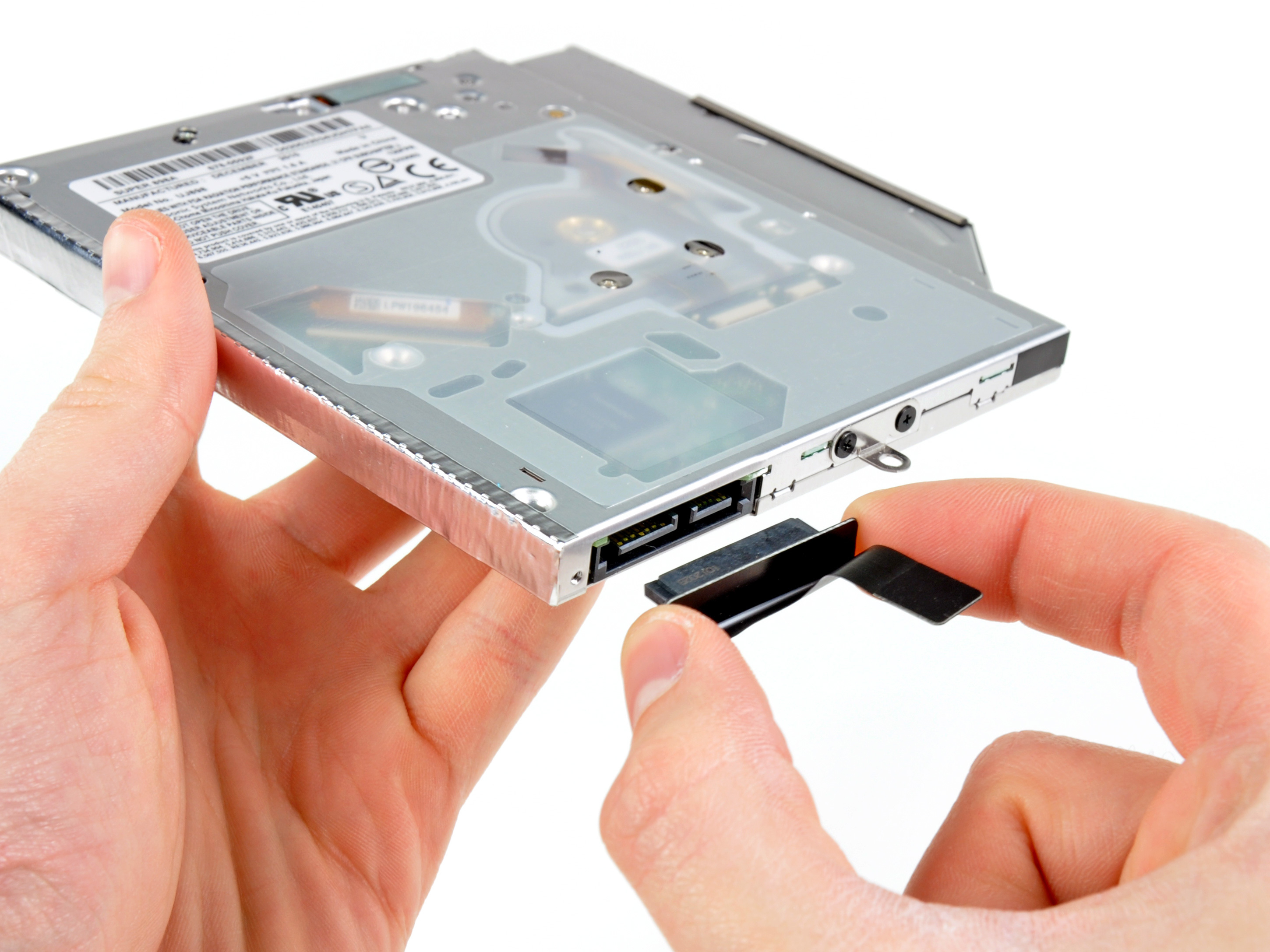

1 Stap 16 Optical Drive  ¶
Image 1/2: Be sure to pull on the connector, not the cable itself.
  • Pull the optical drive cable away from the optical drive.
  • Be sure to pull on the connector, not the cable itself.
  • Remove the two black Phillips #0 screws securing the small metal mounting bracket. Transfer this bracket to your new optical drive or hard drive enclosure.

Basically i had to remove the optical drive by leaving the two left screw's there and snapping the whole thing, it was not the best solution but it worked, the two screws would't come out :)
manelrodrigues19 - Antwoord

Does anyone have a problem that the cd/DVD won't fit in their SuperDrive once reinstalled? I am unable to fit a cd in, as well as eject any cd as well.
Jonathon Derr - Antwoord
