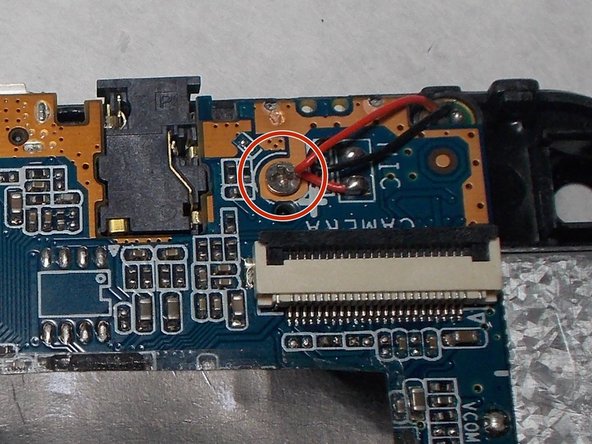

  12. JLab Pro-7 Motherboard Replacement: stap 12, afbeelding 1 van 2 JLab Pro-7 Motherboard Replacement: stap 12, afbeelding 2 van 2
    • Soldering is a very useful, but dangerous technique to use. The iron itself gets very hot. In order to minimize and chance of bodily harm or damage of your product follow our links to soldering safety and instructions pages before proceeding
    • Soldering Instructions
    • Soldering Safety
    • Allow your soldering iron to heat up before attempting to remove solder
    • Once your soldering iron is sufficiently warm place the tip near the solder joints that are circle in red
    • These solder joints should melt rather quickly. Once they have been melted and the wires can be safely removed.
  13. JLab Pro-7 Motherboard Replacement: stap 13, afbeelding 1 van 3 JLab Pro-7 Motherboard Replacement: stap 13, afbeelding 2 van 3 JLab Pro-7 Motherboard Replacement: stap 13, afbeelding 3 van 3
    • This is the last step of the guide
    • There are two screws that need to be removed using the same screw drive given in the tools sections of this guide.
    • Once the screws are out the motherboard can be lifted up and replaced.
