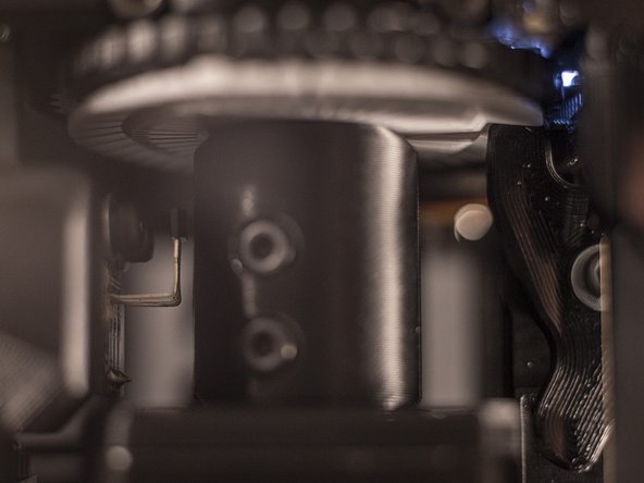

  1. How to fix alignment on an E-TKT Label Printer, Check the approximate alignment: stap 1, afbeelding 1 van 2 How to fix alignment on an E-TKT Label Printer, Check the approximate alignment: stap 1, afbeelding 2 van 2
    • Reboot the device.
    • After the splash screen the machine will home by rotating until the magnet meets the hall sensor.
    • Check the letter J position in the top window: If the letter is visually centered (second image), then you can skip ahead to to Step 3.
