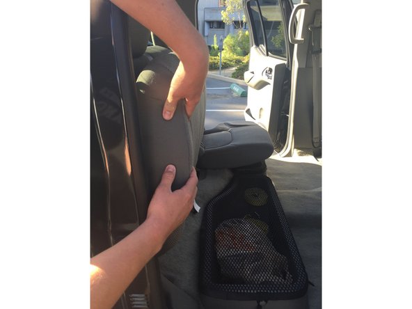

Slide the front seat forward by raising the lever located on the front of the seat, near the console, and sliding the seat forward.
Do this for both front seats.
After sliding the front seats forward, you need to fold them forward as well.
Push up on the lever located on the side of the front seat. Hold the lever up until the seat folds forward.
