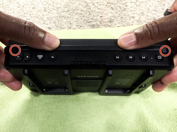

    5. How to Reattach a Loose Sunshade Mount on a NEEWER F700 Field Monitor: stap 5, afbeelding 1 van 1
      • Check the mount, grooves, tabs, and attachment points for dirt, cracks, bent tabs, or poor alignment.
      • Press lightly around the mount to identify the section that lifts away.
      • Lift only that loose section far enough to expose the surface beneath it.
      • Stop if the mount is cracked, missing, or permanently bent. Replace the mount instead of forcing it into place.

    7. How to Reattach a Loose Sunshade Mount on a NEEWER F700 Field Monitor: stap 7, afbeelding 1 van 2 How to Reattach a Loose Sunshade Mount on a NEEWER F700 Field Monitor: stap 7, afbeelding 2 van 2
      • Place the sunshade mount in a position that aligns with its attachment area.
      • Fit one edge into the matching groove or tab.
      • Line up every remaining attachment point before pressing the mount down.
      Vraag FixBot
      Voeg opmerking toe
    8. How to Reattach a Loose Sunshade Mount on a NEEWER F700 Field Monitor: stap 8, afbeelding 1 van 2 How to Reattach a Loose Sunshade Mount on a NEEWER F700 Field Monitor: stap 8, afbeelding 2 van 2
      • Press the aligned edge firmly and ensure it fits securely into place.
      • Move your fingers around the mount and press each attachment point until it sits flush with the monitor housing.
      • Check every edge for gaps or lifted sections.
      • Do not use excessive force. Too much pressure can crack the mount or damage the monitor housing.
      Vraag FixBot
      Voeg opmerking toe
    9. How to Reattach a Loose Sunshade Mount on a NEEWER F700 Field Monitor: stap 9, afbeelding 1 van 2 How to Reattach a Loose Sunshade Mount on a NEEWER F700 Field Monitor: stap 9, afbeelding 2 van 2
      • Attach the sunshade to the secured mount.
      • Hold the monitor over the padded work surface.
      • Tilt the monitor forward, backward, and side to side while watching each attachment point.
      • Confirm that the mount stays flush and the sunshade does not shift or detach.
